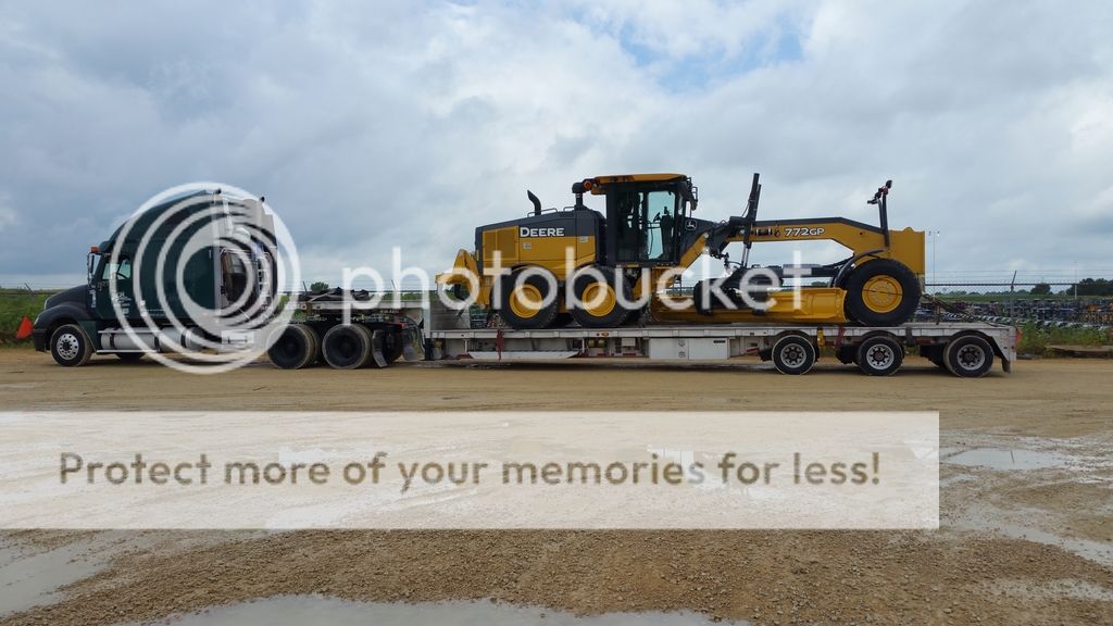

    I pull a 53' Step with tandem spread where the rear axle slides. Also have the HD Ramps kit.
    I absolutely love it the extra length. 43' lower deck with 10' upper deck. Rare to need the upper deck for exclusive loads. I mainly do machinery and equipment. Most of what I do is under 40k lbs.
    How ever, I'm a better to have a not need kind of guy. The versatility my set up offers me, rarely leaves me searching for a load because I cant do something.
    I pulled a 48' all aluminum tridem step for a month while my trailer was in the shop. I was shocked to discover my empty weight with the all aluminum tridem was only 200lbs less than my 53' combo loaded with much more gear. The Tridem was a Wilson. My trailer is a Fontaine Infinity.
    48' Tridem
    vs
    53' Spread
    So in my opinion,.. unless your really specializing in moving that kind of weight,.. OS/OW etc,.. for someone like me who doesnt,.. I'm better off with the extra deck space. Even if its not always utilized,.. I have it for when I need it.
    In all honestly,.. the only place I have had trouble with the king pin length on eastern states is my home state of Fla. Never hassled me for years,.. then all of a sudden twice in 2 months. True,.. they allow 44k on tandems,.. and I could have slid the rear in. Its just such a PITA to slide with a load on. So option 2,.. annual permit. $30 now,.. used to be only $20.
    I been told,.. I honestly do not know the official rule,.. I really should check on it. But been told its a $700 fine in Connecticut to be off the interstate with a 53' spread and over 41' king pin to center axle. Mine is 41.5'. I have personally never been hassled in Ct. As for Indiana and Illinois,.. I a lot of I80 from Oct till I take my winter break in Dec and have never been hassled in either state. I dont do a lot of Cali either as my truck is an 05 and not exactly legal there,.. but even so,.. I have never once been hassled there either.
    Edit:
    Wanted to add,.. not that I specialize in containers. But from time to time I find myself moving them. 43' lower deck makes securing 2x 20' containers a breeze. Single 40' is nothing either.
    Also,.. the low profile step is nice for tall loads. But I had issues with the smaller brakes to accommodate the 17.5 wheels. I smoked them once exiting a ramp. Made sure I exited much slower after that. The carrier I lease on with owns the Tridem. His main complaints are tires and brakes. I have 22.5 wheels on my 53. I'm averaging 130 - 150k mi now using BFGoodrich ST230 tires. I put new drums and shoes on my trailer in Jan 2015. I dont expect to replace the shoes till next summer,.. maybe early fall. See how it goes.
    I'm personally not a big fan of 17.5 wheels. But I do understand their purpose and IF they paid enough for tall loads that need a low profile to justify the added expense thats what I would have.
