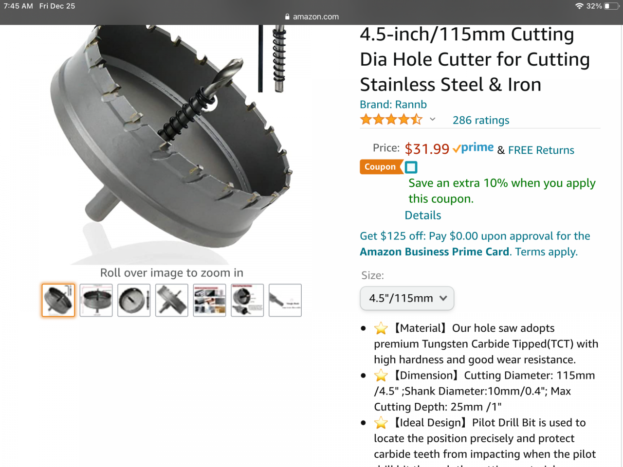

    I was gonna say I'm pretty sure its 4.5inch. I'll have to check for sure when I get back to the shop

    Yeah it’s 4.5 for the lights and grommets I’m using. I didn’t think they had to be that big but they are.
