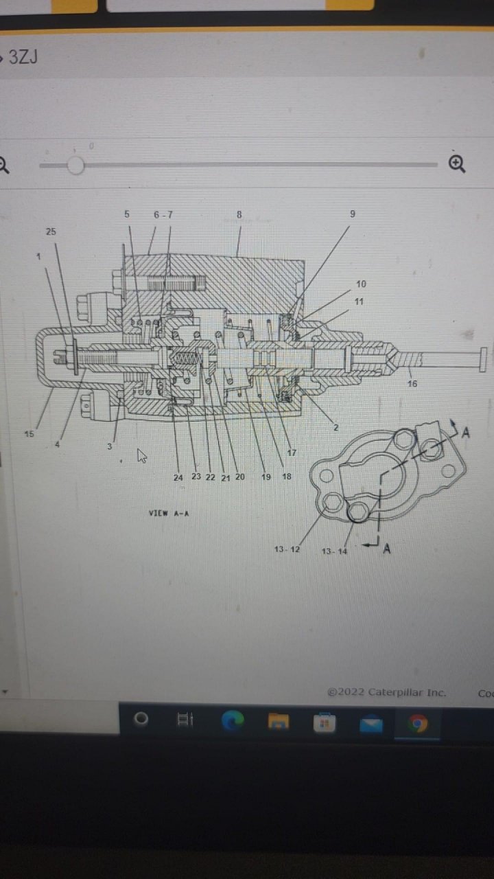

  8. nerv
    nerv Bobtail Member
    27
    13
    Feb 10, 2022
    See photo- This is how it’s assembled, i hooked it from the top and pulled on it and it was hooked up inside the governor. What am i missing here?

  10. wore out
    wore out Numbered Classic
    15,347
    185,318
    Jun 5, 2013
    CHASIN THE DEVIL'S HERD
  11. wore out
    15,347
    185,318
    Jun 5, 2013
    On the pump side there is a throttle screen on the block side make sure it’s in there
