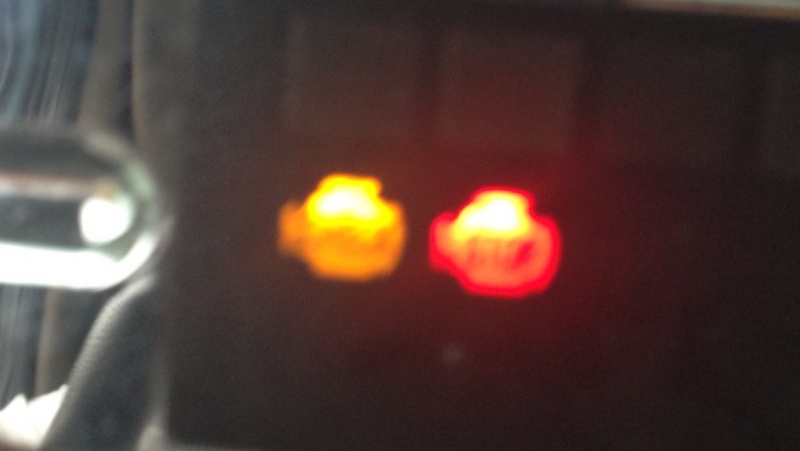

    Have you checked the coolant level? The coolant sensor is prone to leaking after a few years. If the coolant drops below the sensor, you will have the check engine and stop engine lights come on and shut the engine down within 60 seconds. You should have an override switch on your dash to keep the truck running, though you will have to keep hitting the override switch every 1-2 minutes. Check and see if the coolant level is at or near the level that the coolant sensor plugs into the reservoir. If the coolant level is not dropping below the sensor level, the coolant is leaking out through the sensor. If the coolant has dropped well below the sensor, you may have a crack in the coolant reservoir.

    My truck is doing the same thing right now, it's only happened one other time to me and our mechanic told me to pin the ovrd shutdown switch until I get back. Gauges look normal. These things are piles.

    Check the coolant sensor open and clean the sensor. Or replace it. It happened to my 2010. I replaced it that light is gone for goog..
