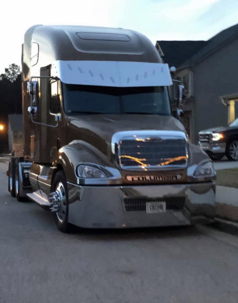

    Anybody know any upgrades I can do to my 14l Detroit? I’ve got egr deleted and custom tune. Looking at upgrading turbo and injectors. Any help or part numbers would be appreciated.
