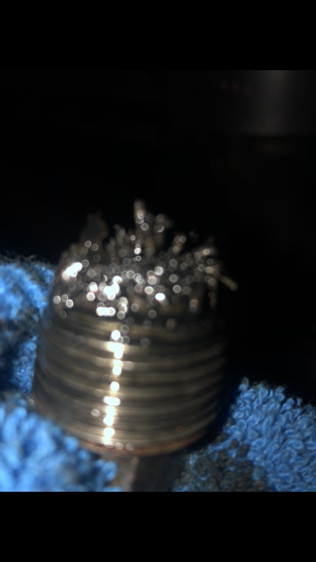

    I’m aware of the first oil change and metal that will be present. May even have a bolt stuck to mine from this circus of idiots lol.
