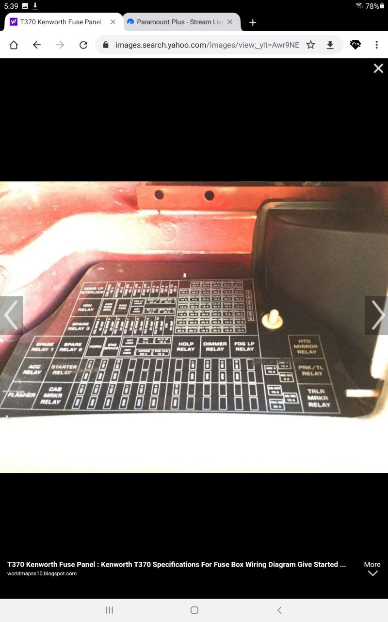

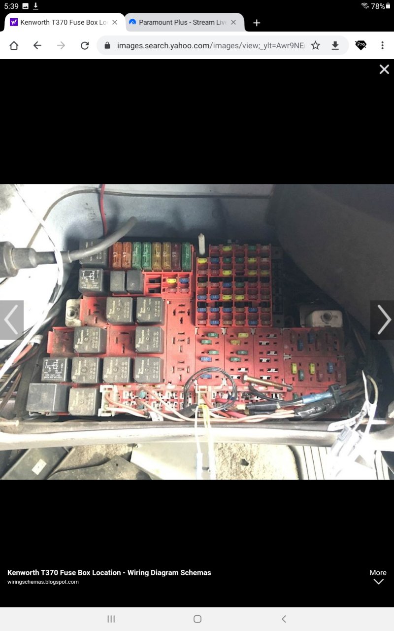

    Did you get it figured out? There is an ignition relay. You could switch it with a relay you aren't currently in need of.
    Screenshot_20211011-173924_Free Adblocker Browser.jpg Screenshot_20211011-173953_Free Adblocker Browser.jpg

    Gave up for the night. I have already switch the relay with a similar one and that did not help. Truck has an ignition relay, ignition fuse (15amp) and the key switch (10amp) Wich is the one that blows. That fuse box in your picture is different from mine. So I wond 20211011_205124.jpg 20211011_205138.jpg er if that's from a older model or not.
