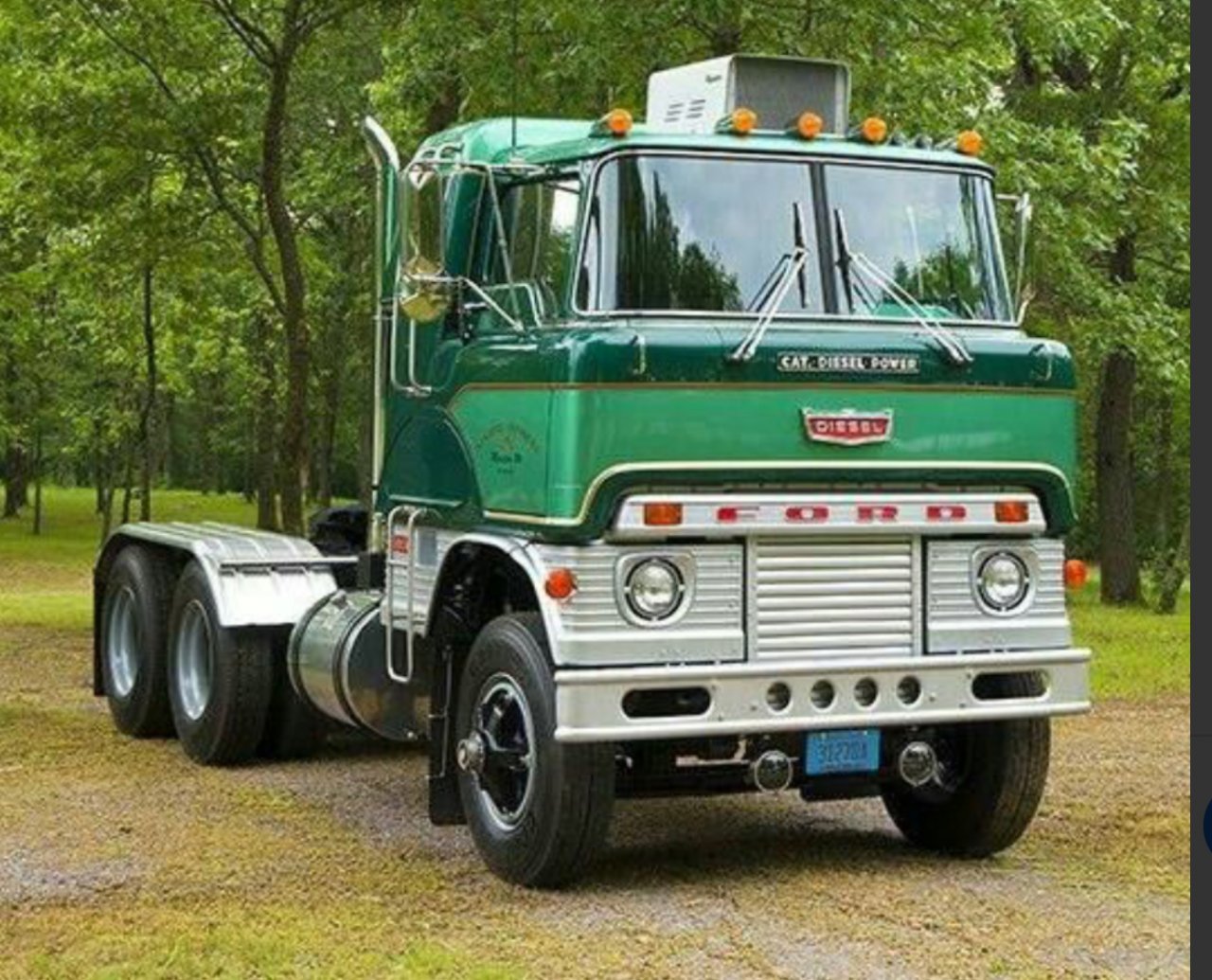

    Anybody familiar with this truck? My main question is do I have to install the oil deflector(?) on the axle ends? If they are in place, how does the oil get into the hubs and subsequently to the bearings?

    Not sure what you are asking but most of the trucks of that vintage had grease packed wheel bearings on the steer axles. (Just like a car did). If it has a solid steel hubcap with 3 or 4 or 5 bolts holding it on than that is what it has. Stemco type oil filled bearings were very rare in those days.
    The drive axle bearings get oil to them the same way all the new trucks do.

    2 story Falcon. What kind of axles, do you know?

    I think I read, the H series was one of the 1st Ford trucks to have a diesel from the factory.

    Not sure when the first diesel came out in a Ford. I know a lady that has a ‘65 N series that has an Nh220 743 from birth. The N’s were tighter fit because cab sits much lower.

    1A939733-6B88-48CA-B687-B7E27C806329.jpeg Here’s her truck. She stretched it a little and singled it out on FL airliner rear.
